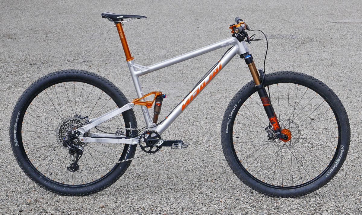

Nicolai Saturn!!
Nicolai-Saturn11_aluminum-alloy-105mm-XC-cross-country-trail-mountain-bike_Raceline-complete.jpg
Just checked your budget!
You'll probably only have enough to buy the front triangle.

who sells Nicolai,
can see any Aust distributor

There isn't one, you need to import and they build to order. And you want to take your current budget, and then change the AUD sign to a € to get the price on the frame only option...probably without a shock as well.
Yeah, but you'll be the only W.A. resident with one!

Very nice ! And rare as hens teeth.
Not so (well kind of o_O). Up here (Sunny Coast, Qld) there's at least 3 or 4 of us getting around on Nicolais... A couple of G13s and a G16 amongst my riding mates. But true, I haven' spotted a Saturn-11 anywhere in Oz... certainly on my wish list though.

Sweet jesus that nicolia is brilliant. If all xc bikes looked that good I might maybe kinda consider an xc bike. Maybe.
