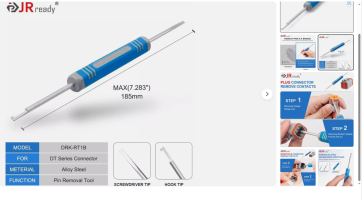

I have this situation with this Deutsch plug.
Can I strip the sheath back and get this back in here somehow?
I'm late to the party here, but for future reference, you can remove the pins from deutsch plugs and sockets....first have to remove the front sealing piece, you may need to butcher a small terminal screw driver to get it out..then there is a small barb that holds the pin in, you need to push this back to push the pin out (if some numpty has busted off the wire) or pull the wire if still attached..the socket end is slightly different, where there is a small plastic divider that needs to be pulled out, if you look in the socket at it, you will see a very small notch, grind your service tool to slide into the slot with a small recess in it to get in behind this, and then you need to twist 90° to pull it out...pins are held in the same as the plugs......
