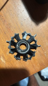

Very interesting.
Given my history with idler pulleys it's probably not a solution for me..... pic is the idler I just pulled off my Norco Range... it was still working!

Jeebus. What does the rest of the bike look like!!?!?
In my defence... the Norco idlers are absolute junk. And if you want the NS Billet one they only do it in alloy and costs and arm and a leg so you're stuck. You need a new one probably every 6 months with moderate riding.

If you own the bike for a while surely getting the NS one would pay for itself or are the idlers from Norco cheap?
NS Billet ones are alloy only for the Range. They do make steel for some bikes but not the range.
I’ll probably risk it next but it’s $90 vs $45
This really makes apparent how much wear and load goes through these idler wheels...
Say for a 32T chainring and a 12T idler that means it is spinning at 2.66 times the rate of your cranks, plus carrying a heap of load as the suspension keeps pulling on it. I'm not surprised they are wearing so quickly.
