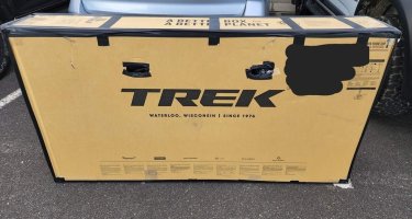

A free bike box from the shop is a cheap way of putting your back out.
Your carrying a 1.6 - 1.8 meter box around with 25 -30kgs sideways. It's cumbersome and gets in everyone at the airport just walks into the pathway like a magnet. I duct tape the bottom to make it easy to slide it along the floor, and sides and handles to prevent airline damage.
Better to Invest or borrow in a proper bike bag with wheels like Alberk or Evoc with wheels. Then sell it when your finished with it.
