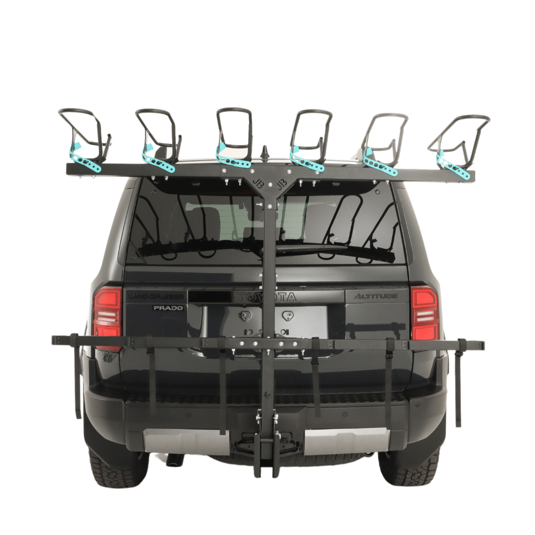

JB 4-5-6 bike racks, shed stand and loading strut for $999. Additional $20 off with JB20 code.
Unsure of quality but its a cheap way to carry a family load of bikes.
