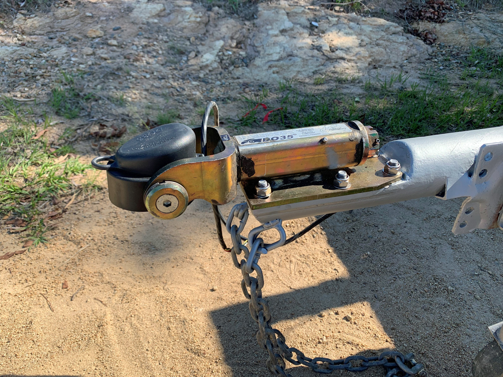

As long as you can do the weldering downhand it should be ok. I had to weldings the trailer coupling section overhead and vertical up though the joggle was downhand. Fuck I hate overhead. It hurts even through a cap.
Anyway nothing a grinder cannot fix.

Welds should never run crossways on a longitudinal member, it creates a stress riser and will cause it to crack and fail.
