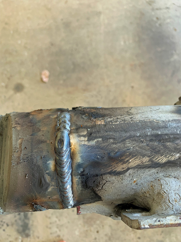

Seem ok here -
Welds should never run crossways on a longitudinal member, it creates a stress riser and will cause it to crack and fail.
Huh? The structural standard dissuades welding across a tension member for temporary attachments though that is for other reasons. How pray tell do you join something? Butt welds are fine and a joggle weld with the horizontal section (in this case) on the neutral axis is fine. That weld is the cap over a root run. Both sides single vee prepped and the undercut where it appeared filled... not to mention that is an unbraked box trailer with a gvm of 750kg. I did the calcs when I first built it, stress was just about...
fuck all.
fuck all.
This is what I am talking about. any part of the draw bar should not have welds that run across the frame member, they should run inline with the beam. This goes for up near the tow hitch as well.

Where is that applicable in what I have done? That doesn't mention the coupling and there are plenty on the roads with welded on couplings on the top of the drawbar. My weld across is at the neutral axis. The structural standard AS.... allows for permanent weld across structural members. The standard recommends not welding temporary attachments across the tension side of a flange because temporary attachments are usually not welded to the same quality as permanent welds and can introduce undercut and craters which are stress raisers and can lead to cracking. We had a P91 header that the guys in the yard welded carbon steel transport frames to because they didn't know any better. Those welds cost about $100k to make good by the time they were ground out, tested, filled, tested, linished flush and tested.
That pic you posted is bullshit anyway and comes down to the welding and joint design. They are concerned about flexing and undercut or poor weld at that joint allowing flexural fatigue. Not applicable. The load at the coupling end is shear of 75kg. There is no flex.
