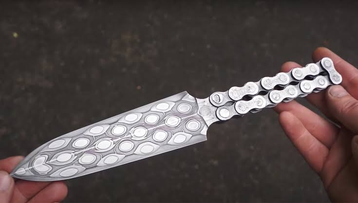

That is very, very, very cool!Many of these?
