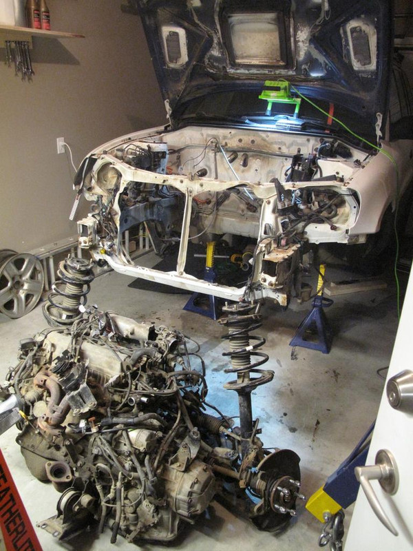

Here is one someone prepared earlier. Front right hand aide. See the cable running right to left across the front? Just above the front engine mount. Probably have to pull some plastic off to get to it.
