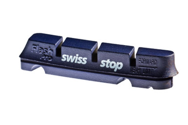

I have the same calipers, changed my pads from the stock Shimano to DTswiss pads and they are so much better. Got these (for Al rims):
(better prices elsewhere, just the first link I came to)

Weird that you didn’t have any luck with new pads @Coopz - even the standard Shimano pads are pretty good. As above the blue Swissstop pads are excellent on aluminium and contrary to @Haakon ’s moaning you should be able to get them set up well.
