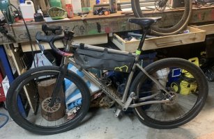

Jizzed up my newly built 27 mm internal disco wheels. Hope hubs I got off Rusty years ago and db spokes.
2 litres for 18.00 dollars cost . Used 500 ml thickened latex and ethylene glycol I had lying around and water. Bio glitter leftover from kids party. Needed more something, so took fj’s idea onboard. Made it more ‘race’ though with soft compound rally tyre and go kart slick rubber. And some rubber fuel hose as I read somewhere to add fibres.
Sealed up first time.
160 ml per 700 x 50 tyre.
I have always seemed to go through a fair bit of sealant on the trail. Am forever cleaning goop off frame when doing clean and service.

Is there a reason for so much sealant for each tyre?
