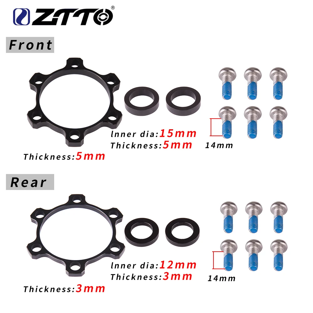

Using non boost wheels in a boost fork - I assume this is possible.
How do I do it?
Is it just shims for the rotor and a spacer?
*Edit just did google and amazing how some shops want $50+ for this!
Some kits made for certain common hubs actually replace the end caps so there's no spacers to risk dropping when you take the wheel out (ie: WolfTooth Boostinator), but yeah $50 is still a lot for what they are. Could be a potential ride-saver though if you have to pull a wheel off to get the bike in the car and were to lose a spacer (for example), so YMMV.
