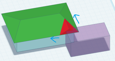

My house has eaves all around it. In one corner of the yard I would like to add a single-car garage, but for the garage to be decent-sized (ie: able to fit a large car in it lengthwise) the eaves of the house would prevent moving the front of the garage coming forward enough. The block is small, so no room to move the garage further back or away from the side of the house. Roof is too low to build under, and proposed garage would be up against, but outside the exterior walls of the house. Ideally the garage roof would be quite a bit higher than the house as I would like to build it canted to take advantage of potential solar-panel real estate, so ...
How would a builder/plumber make such a thing happen without having water flood into the roof everytime it rains? I feel like it should be doable, but can't visualise it in my brain... Blue outline is where I'd like to place the garage, and black lines are the roof layout, and blue-filled area is where existing roof would need to be removed and modified for proper drainage.

What's the clearance under the eaves? What height do you need the garage to be?

You'll need a skillion roof of some type otherwise you'll end up with a dog's breakfast, and all your leaves and crap will be caught between the two roofs.
Skillion roof would be the easy bit, but it doesn't mean I can send walls through where the existing roof is currently.
@indica - not really. The aim would be to have something enclosed. I have a long/narrow carport on the side of the house already.
I hoped to put a garage on the other side of the house, but the local water authority won't allow it. Pretty much working out if I stay in this place or move.
Eaves are about ~2250mm from the ground, and 600mm to the outside of the fascia board/trim (ie: excluding the gutters). Probably 3-3.5m tall at the house side. Not aiming to stick a hoist in or anything like that...

If the garage walls are going to be higher than the existing roof line.
Box gutter horizontal in red discharging to flashings in yellow on the roof pitch.
Not ideal.
Or if the existing is a pretty low pitch fill the triangle in on the existing roof where the box gutter is and effectively creating a half gable to a ridge against the garage wall looking from the bottom of the drawing.
If it was a carport (no sides) you could support that section of the carport beam above the existing roof via steel post through the existing roof
