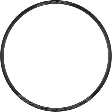

Does anyone have anything bad to say about Race face AR offset rims?
I'm in the market for a new rim to replace a Stans crest mk3 that's splitting at the spoke holes (previous owner I've never ridden it). The bike is a 29xc hardtail that is not going to see heavy off road use (it will be my wife's bike or my son will steal it to ride to school)

MMkayyyyyy thanks for the feedaback should have searched better, time to rethink the plan on the AR25...
Any other COLC (budget) friendly suggestions 32H 25-30mm width? use case is non @ozzybmx's once were bike smashers, the Hallion has his spitty for that and wifey will probably never ride it.
