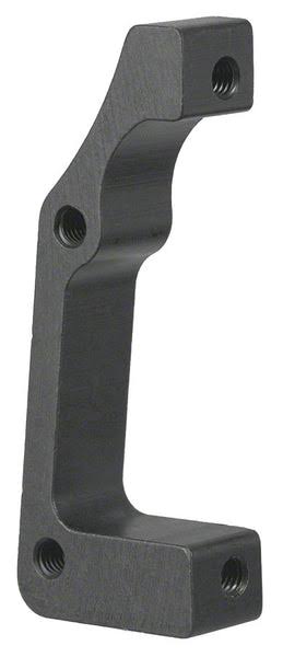

Does anyone here have both a 20mm boost hub, and an early Marzocchi 20mm axle fork with I.S. brake mounts?
You know, the ones that required the wide/thick brake adaptor. (Most Marzocchi's before ~2007)

Lots of older marzocchi's used this much thicker brake mount. ~5mm wider than others.
(Early 2000's Shiver, Z and dropoff series. Probably junior and super t's did too.)
Boost hub has the rotor mounts 5mm further out from centre.
These forks have the I.S. brake mounts ~5mm further out from centre.
The question really is; can a boost hub and a standard thickness adapter be used together on a Shiver. Etc

It won't work because you can't space the brake adaptor out another 5mm and the rotor might foul on the leg too.
So I just tried this on a shiver and early boxxer and yes it does fit, only problem you may run into is disc bolts or rotor touching fork leg on some models
Does the rotor line up with the brake caliper, we know the axle is the same length.
