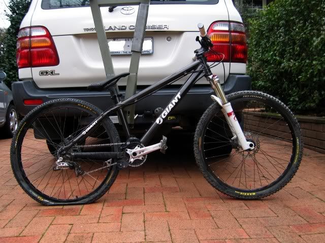

Just thought I would post up my bike.
It's an 05 giant stp zero and it's taken a fair amount of riding since I bought it. It's main usage is for 4x and general razzing. Sorry for any shithouse photos.

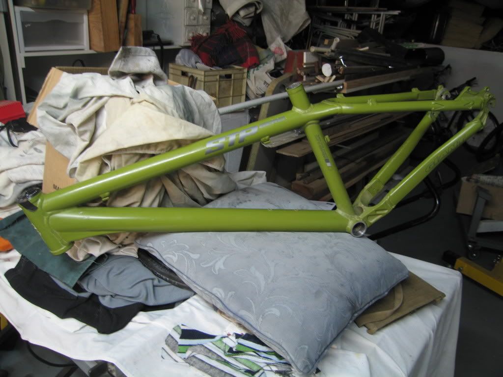

Here it is close to stock:
Here it is at the moment:
Frame - Giant STPzero 05 (Metallic Charcoal w/ cut front derailleur guide)
Front shock/fork - Manitou Minute Elite Super Absolute 100mm
Handlebars - Sunline V1 750mm
Stem - Sunline V1 am 50mm
Headset - Cane Creek
Grips - Sunline Logo Lock Ons (white)
Saddle - Funn Skinny RL
Seatpost - Easton EA50 (cut down)
Front brake -Hayes nine 6" rotor
Rear brake - Hayes nine 6" rotor
Bottom Bracket - Shimano xt m770
Cranks - Shimano XT 170mm
Chainring - e13 Guide ring 34t
Chainguide - e13 lg1
Chain - Shimano Dura-ace
Pedals - Shimano PD-M424
Rear derailleur - Sram x9
Rear shifter - Sram x7
Cassette - Shimano Ultegra 11-23t
Front hub - Formula
Rear hub - Shimano Deore
Front rim - Sun Rhyno Lite xl
Rear rim - Sun Rhyno Lite xl
Front Tyre - Maxxis Highroller eXCeption 2.1
Rear Tyre - Maxxis Larsen tt eXCeption 2.0
Tubes - Maxxis Flyweight

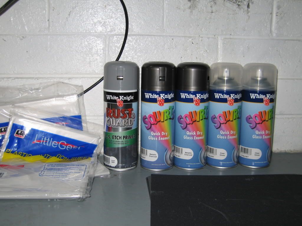

Ok, so today I went out to buy all the stuff for respraying the frame. I've decided on white knight metallic charcoal paint. I also stripped down the bike to the frame and started sanding it down. I might try to way all the parts later on if i can get a decent set of scales. I've now noticed just how farkin heavy marzocchi dirt jumpers are, holy crap is all i can say! They'll be going fairly soon though. I'll either be getting some pikes or the 09 reba's with 20mm axle look the goods as well.
Pics:
I've got some questions that need answering as well:
1. With the painting, I've decided to sand the frame to a decent level, primer, coat and clear coat it. Will getting rid of the paint with paint stripper be beneficial or produce a better overall finish? Perhaps getting it bead blasted may be better (although more pricey).
2. About how many layers of clear coat are needed?
3. Will isopropanol (sp?) and other thinners do the same job as prepsol when it comes to degreasing the frame before painting?
thats a sick bike, you should have used plast-kote or what ever its called, there panits are a shit load stronger and look much better.
Hahah good luck w/ the sparay job.
Was gonna go plasti-kote but they have a pretty average choice of colours. Hopefully the whiteknight turns out well though. I like the colour anyway.

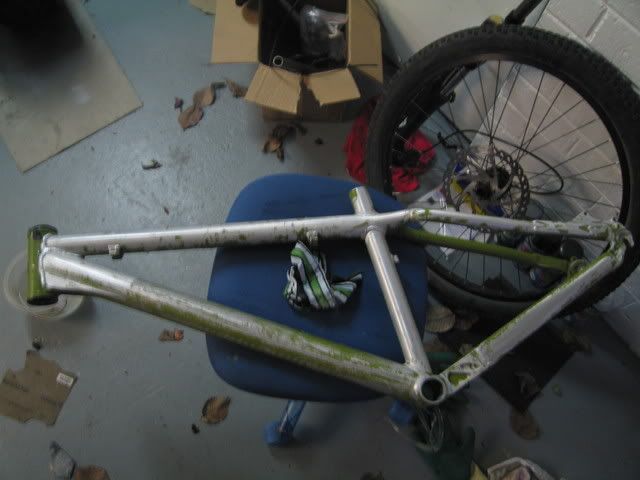

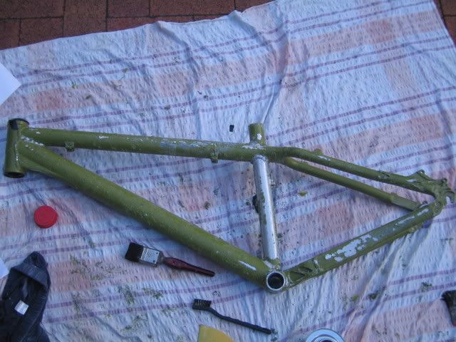

Ok, so I started stripping the frame today. I made abit of a mess and it was alot harder than I thought, kind of frustrating sometimes. It was a pretty cold day. The stripper I used is called k+h fast acting paint stripper. Anyway here are a few pics.
The frame with the stripper on it.
The paint bubbling.
The frame as it is at the moment (I'll work on it more tonight)

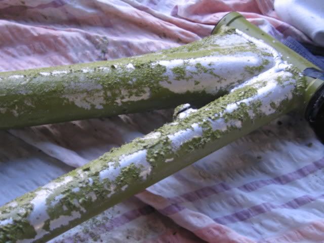

Some of the paint was really stubborn and is a pain in the ass to get off. Here's a close up of the bottom of the downtube.
So I kinda had abit of a cock-up but this is all new to me and abit of a learning curve.

you picked a good primer, but the paint i wouldn't recommend using.
you can get ones just for metal surfaces and the clear coat isn't needed if you hav done a couple of layers of the coloured paint.
i used some of that same paint on mine for little details and it defitnately didn't do as well as the paint made for metal surfaces.
just my thoughts....
Hey, Its Robbie,
I just repainter my BMX from orange to black, i just left all the paint on with a bit of a sand down, i used $3 paints and it turned out really nice, I also used the same clear coat that you will/ have.
Good luck with it!

So I got the headset removed and now I've started to do abit more stripping. Again, some parts are really stubborn and are very hard to get off while other bits come off reasonably easy. I'm kind of regretting not just getting it bead blasted.:(
So does anyone have any ideas of how to get the really hard bits off? or maybe I'll just sand them down later.

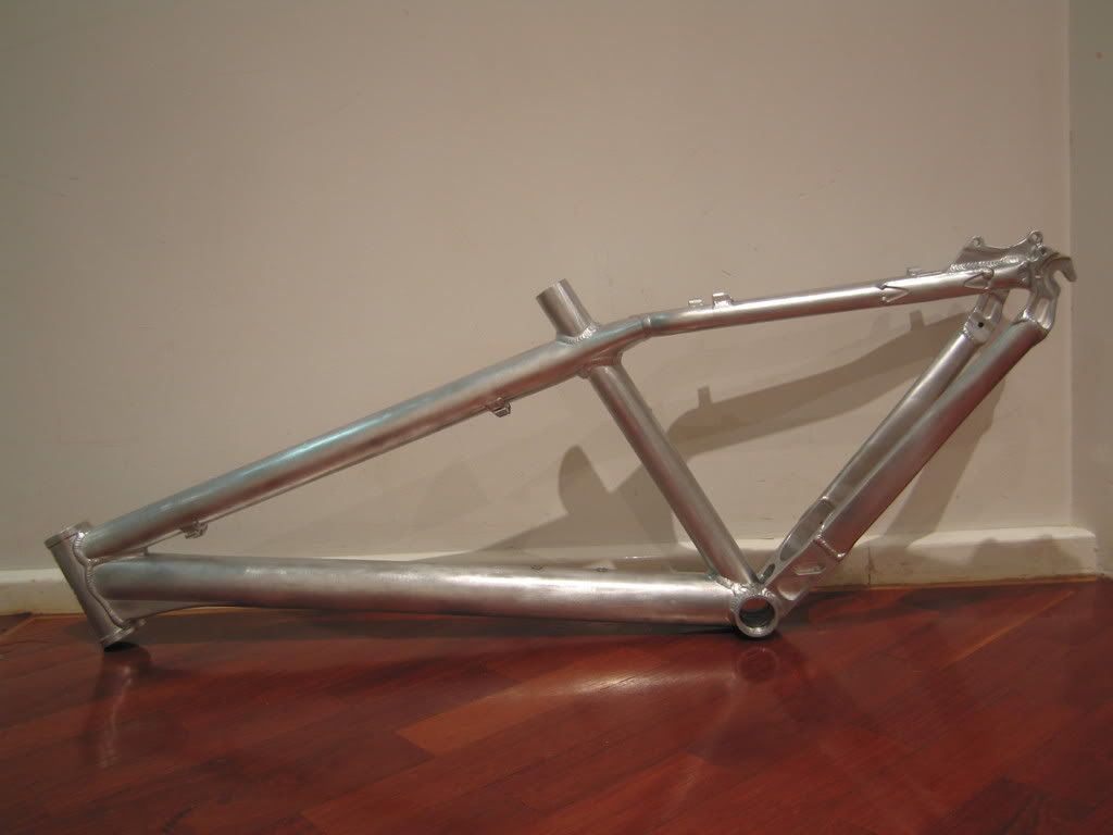

Stripping is done.
Just gotta give it abit of a sand down, degrease and start painting.
Oh and I also took off the front derralieur cable guide for a bit more cleaness.

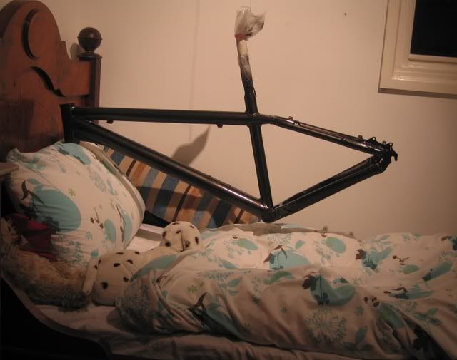

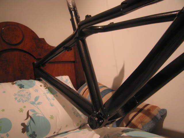

Painting is finito!
Pretty happy with the finished product. Just gotta let it dry over night, polish and wax it then build her up again! Stoked.
Oh and that's my sisters room in the photos by the way.
