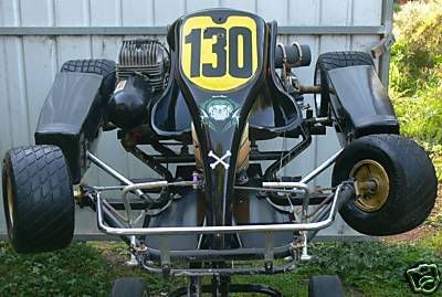

then i found a gem. an old kart frame (not a racing one or anything, think off road kart with no suspension, picked it up for 30 bucks, came with an old 3 speed postie bike gearbox, so the old lawnmotor engine went into that, much nicer, still one wheel drive though, went very well, topped out at about 60.
