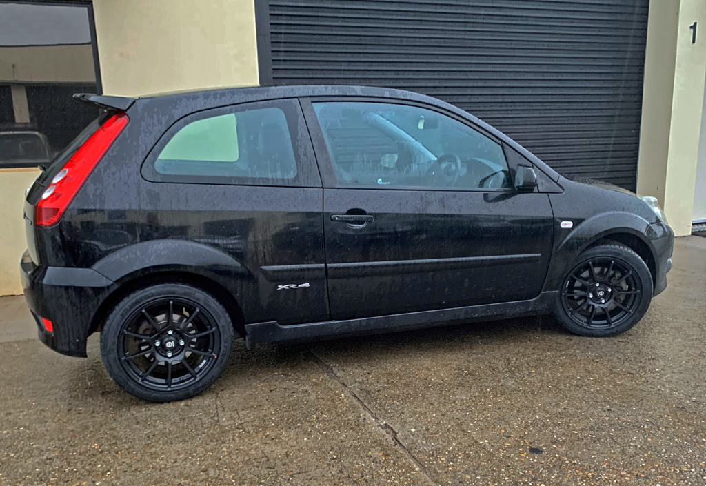

Time for some new tyres before the last two events of the year. Nankang AR1s going on. Skim the brakes and clean up the pads and give it a brake fluid flush. Had all other fluids done before the last sprint.
Should have been an hour or so all up but had my own pedal nut issue.

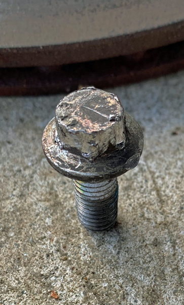

Obviously rounded off when the brakes were done last time about two years ago. Could have been me or several others... Anyway luckily there is heaps of room around the caliper carriers. NOT. Tried all sorts of things but couldn't find my fucked bolt removers. Suspiciously missing. Ended up with the vice grips which rounded it even more and that let me drive a 12mm long spanner on and got it loose. Didn't want to weld a nut on given the fuel and brake lines are really really close. New bolt time. New spanner time. And buy another set of nut and bolt extractors. Damn.
