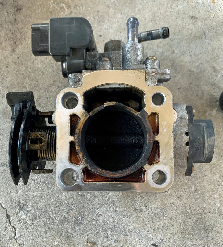

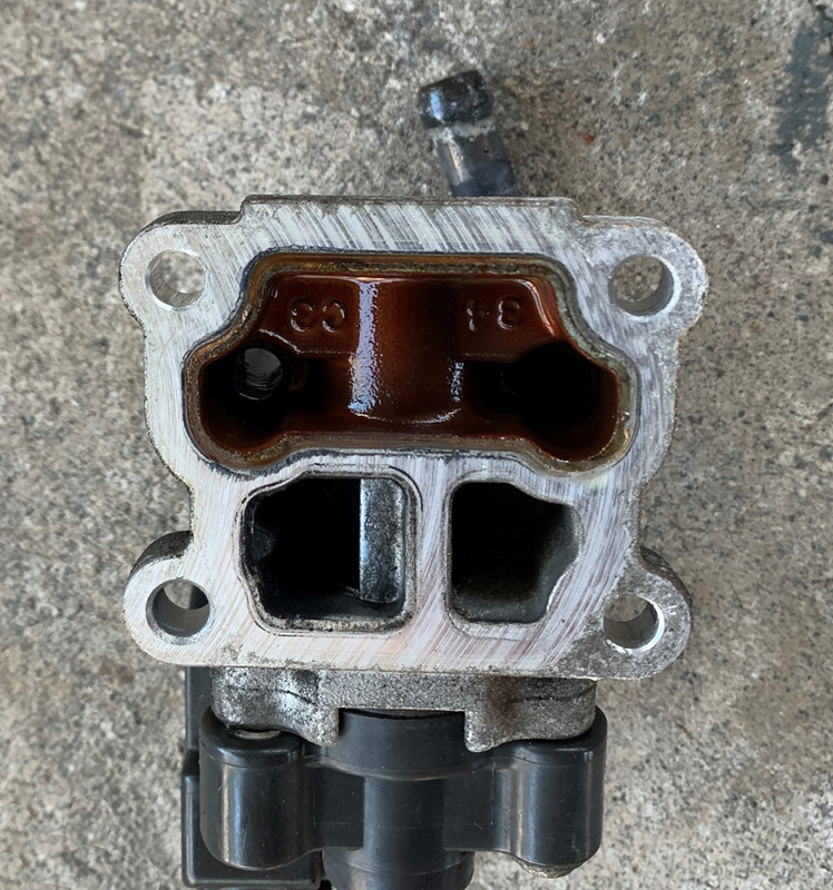

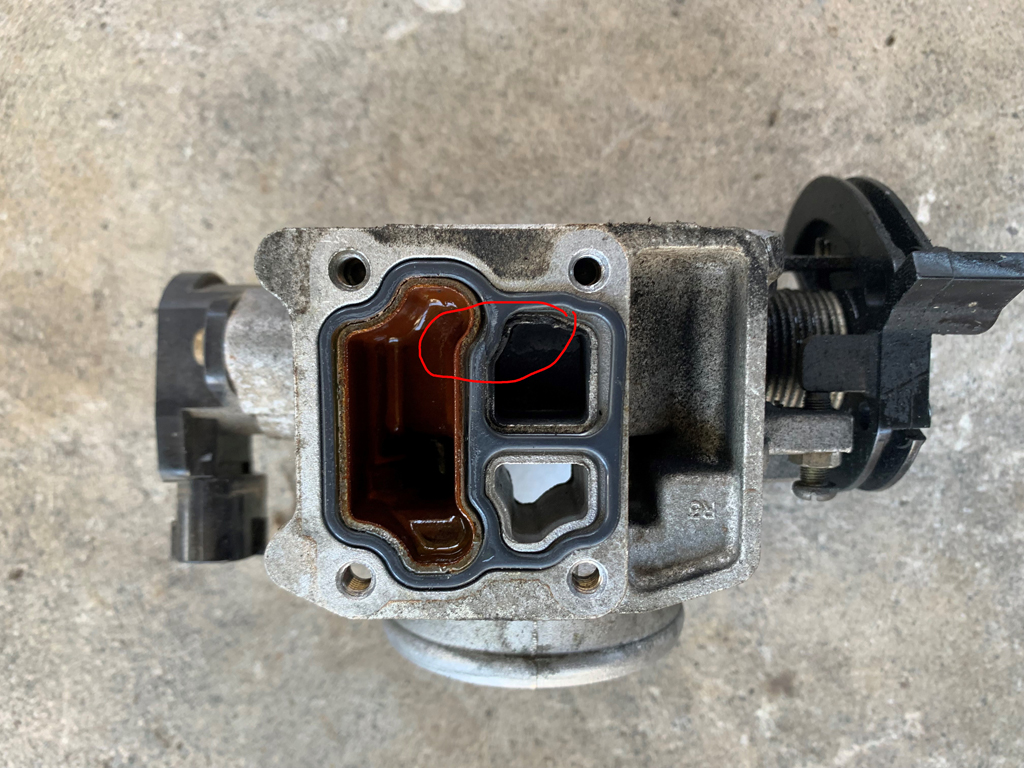

Just an update to the plight of the Jimny idle. It has been much better but still not 100% - which might be a big ask but a man needs a target.
I ordered a new throttle body gasket since the factory one was looking a bit ordinary. Swapped it over and gave the IAC another blast of cleaner. It must spin freely with as least resistance as possible.
I suspect the gasket might have introduced an air leak messing up the idle, or the gasket was letting in some bonus EGR air gumming it up a bit.
I am slowly getting there as a Jimny intake specialist if I like it or not.
See how it goes, the sequel :)

I found that the spinny thing had tightened up while I waited for the o ring. So I gave it another blast. The o ring was gooped in place so it had been apart before and that was likely when the o ring was damaged. Anyway under $100 for new belts, new hoses, new o ring and 76 cans of carby clean later it idles like it should. Actually wasn't a bad drive when I handed it back.
