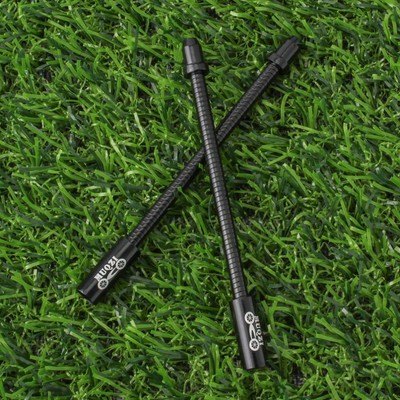

Actually thinking about something like this to make the bend around the BB angle:
Would probably wrap it in electrical tape or something waterproof to keep it quiet so it's not banging around in there... thoughts?
Run the cable around the underside of the BB & use the BB sleeve as the minimum radius to prevent kinking at the ST/DT junction?
