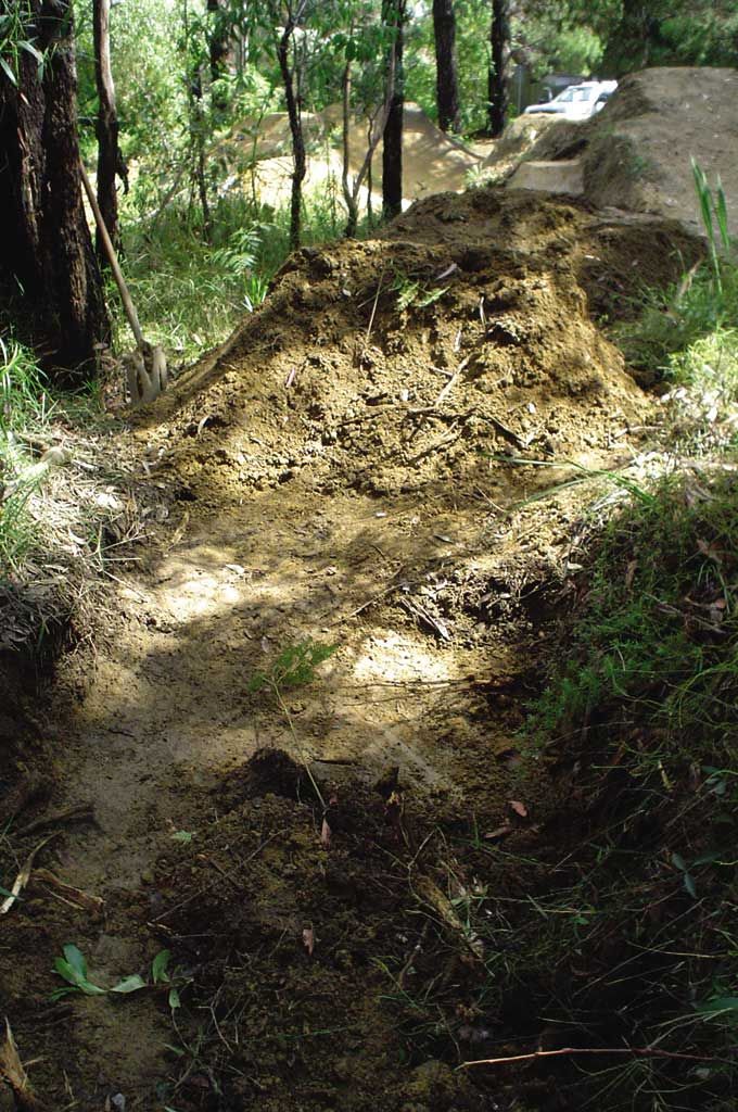

• Digging Pits: If you’re a beginner you’ll want to dig well off to the side of your line so that if you goof out you won’t crash into a big hole. But if you’re confident it’s a good way to get dirt by digging pits in between the 1st, 2nd, 3rd, 4th etc. jumps to land into. This makes for taller jumps and gives a better ‘pump’ between them. You should also dig out the actual gap of the jump itself. Generally to get a rhythm section to work well the jumps get progressively bigger and bigger as you build up momentum thru the pack.
• Kicker: So, as you’re digging pits, chuck the dirt in the spot for the kicker. Build it wider than you think is necessary because it make it easier to build taller. As you go, compact it by whacking it with a shovel on all sides and even jump up on top of it and stomp it in a bit. When you’ve got it to the height, width and angle that you want and all the sides are compacted, get out the wide flat headed shovel and give the face of the jump a good smoothing over by sliding the shovel up and down till there’s a smooth and even gradient. Then let it sit for a couple days.
http://i2.photobucket.com/albums/y23/Randells/dirtjumps_4.jpg
http://i2.photobucket.com/albums/y23/Randells/dirtjumps_3.jpg
• Lander: A stepped up lander is great because it allows you to go a bit faster, boost higher and throw tricks easier, but that normally means shifting a whole lot of dirt. When building a lander, you want it to be at least twice as wide as the kicker so you don’t have to be really precise when landing. You can also use a bit of fill like small logs etc. for the base of the landers and you can use the dryer, dustier dirt because it doesn’t matter quite so much and just like the kicker compact it as you go. Give it a good smoothing over and let it sit for a couple days.
