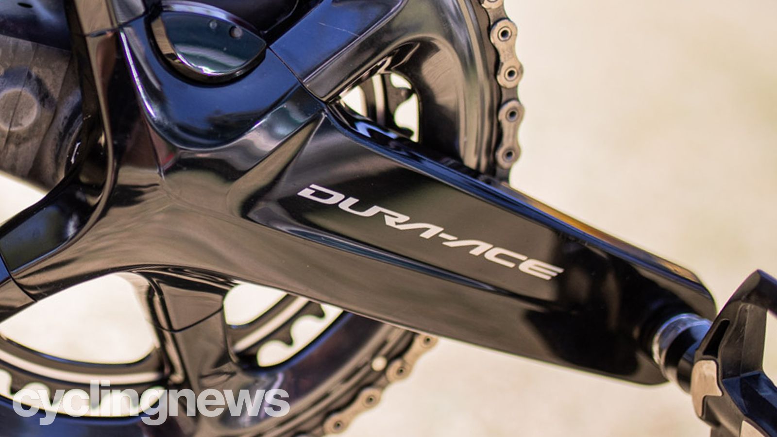

Shimano to recall 760,000 Ultegra and Dura-Ace cranksets due to risk of failure
Worldwide 'inspection and replacement campaign' comes as six people injured in North America
Meanwhile at SramHQ"If you are in North America and believe you have an affected crank, you are advised to immediately stop using it and contact a Shimano dealer or an authorised inspection centre (essentially any store that is familiar with Shimano components and has passed Shimano's maintenance course). The dealer will then perform an inspection, and where signs of delamination or separation are found, a free replacement will be issued. "
From the Hambini video this seems to be a design issue, not manufacturing. It is astounding how they could elect to only replace upon inspection rather than just replace no questions asked.
For example I had an Ultegra crankset on my old roadie which mostly sat on the rack and was ridden a couple of dozen times before I sold. It still looked mint and no doubt would present no corrosion issues on inspection. Whos to say with the new owner they don't put it through high mileage sweaty/beachside riding and it fails catastrophically despite an inspection earlier cleared it as being OK?
In Shimanos case, cost of X is more than replacing all cranks under recall, however the cost to replace some cranks is even less.Meanwhile at SramHQ
I'd say it's a bit of both, but more manufacturing given it's a glued joint that is failing. Yes it's a bit of shit design to conceive a crank where the inner & outer faces are glued rather than welded (like older Hollowtech models), but ultimately it's during the manufacturing stage where inadequate preparation of the bonding surfaces (residual oxidisation or contamination) has resulted in inadequate adhesion of the glue.From the Hambini video this seems to be a design issue, not manufacturing......
If you look at the number of failures compared to the number of cranks being recalled, the proportion is well under 1%. So yes, it is a bit of arse-covering, but the probability of the cranks failing is actually very lowYeah its a bit of bullshit, an arse covering exercise. Other words we know its an issue and will replace if they look like they'll fail. If they fail and you were told to stop riding until inspected, your fault.
Actually did happen to a good friend of mine while riding earlier this year. Luckily he didn’t stack too badly.but the probability of the cranks failing is actually very low
Worldwide 'inspection and replacement campaign' comes as six people injured in North Americawww.cyclingnews.com
Despite their similar appearance, Shimano's 105 chainsets are not affected by the recall, due to their cold-forged manufacturing process rather than the bonded construction found on Ultegra and Dura-Ace. Likewise, no 10-speed or 12-speed components are affected.
