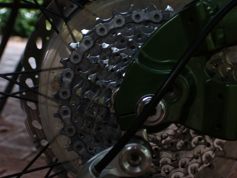

Hey Well the chain is not jumping down or up just seems to be jumping in the same spot as if the cassette is really worn cause it only happens when there is a bit of pressure on it.
maybe thats it but i didn't think it was that worn cause the old x.7 and chain was workin fine.
Also the chain is brand new (Shimano XT) like the deralier and have done like 500 meters all up.
Here is a pic of the cassette look at the fourth gear (chains in second) do you think its worn enough to just skip when there is a bit of pressure put on it.
Yeah, new chain + old cassette = skippage.

The teeth look reasonably worn, but really, there are so many factors here, there is no way we could tell.
Seriously, if you whacked on a new chain with an old cluster, and it started skipping, it's time for a new cluster!
