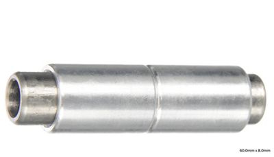

Last time I bought a frame without a shock was over ten years ago; am I going to need to buy shock mounting hardware for this?

The image in the listing looks like I probably will, would be good to add it to the CRC order if I can but not certain what I need.

The document is vague about what these parts are, are they likely to be specific to the GT or something fairly generic?
I would proceed assuming you will need to (for budget purposes), but not purchasing it until confirmed.
Seems like if I'm ordering the shock from CRC I might as well chuck something in the basket:
But I don't know what I'm doing here. I could just ask cycling deal, but I have a suspicion they won't really know.

At that sort of price it won't hurt if you end up with spares. Are you using a manitou shock? Because they won't be much use with a fox
