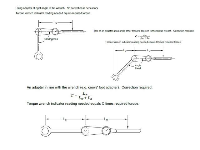

As long as the crows foot is at 90 degrees (as shown) it doesn’t alter the torque applied as the length of the “moment arm” isn’t effected.
There seems to be a bunch of different calculations available for if working with an offset, but 90 degrees is always no compensation required.

I wouldn't use anything thin as you might measure the movement with in the tool interfaces, possible ok at low torque values. Ford from memory tells you not to use any adaptor over 2"at right angles.
The 2" max extension thing rings a bell, but aircraft industry certainly isn't shy about using crows-foot adapter at 90 degs for some fairly high-torque applications (due to stupid access restrictions that prevent use of a socket).
images
Yep this. Or if not aligned at 90 degrees just divide original wrench length by new extended length, and multiply by required torque, to work out setting for wrench
