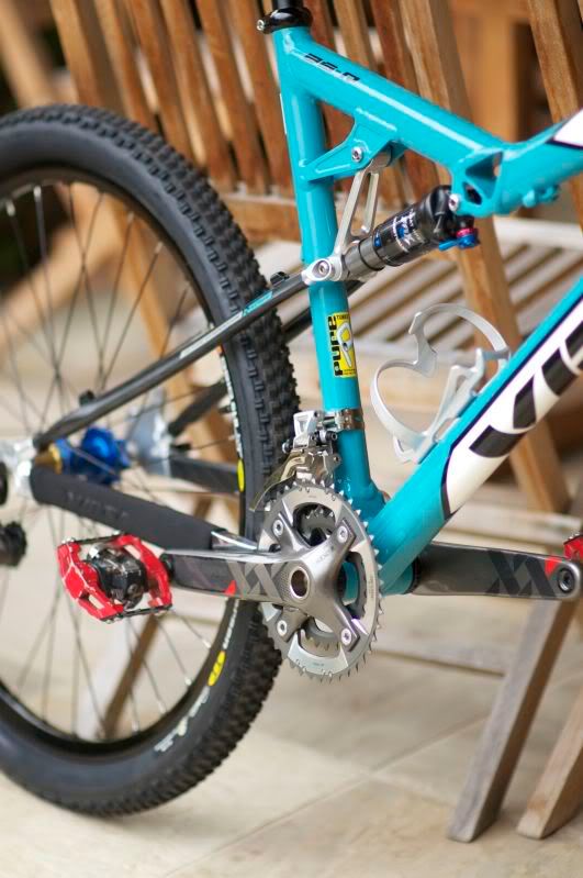

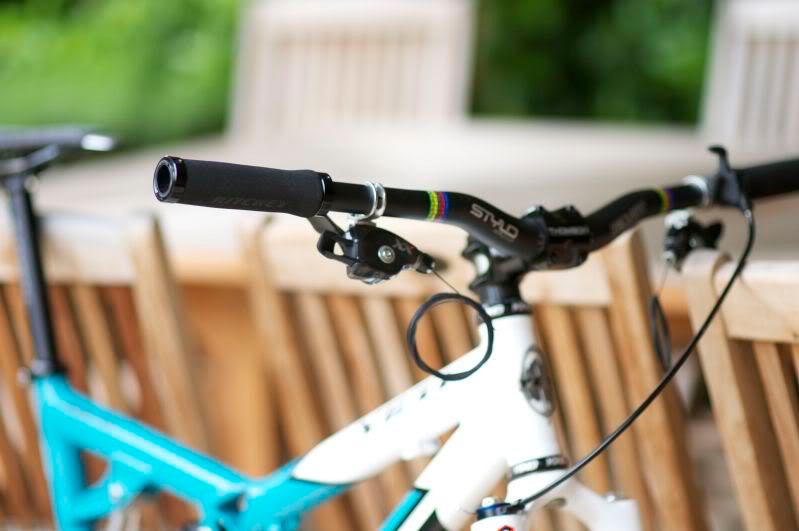

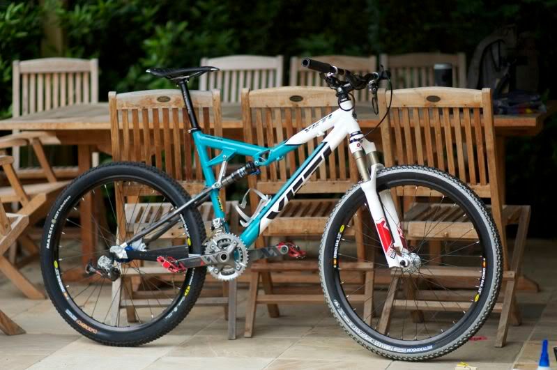

Here's the build so far
And here is the Vintage, but still used and reliable, MTB it joins:
