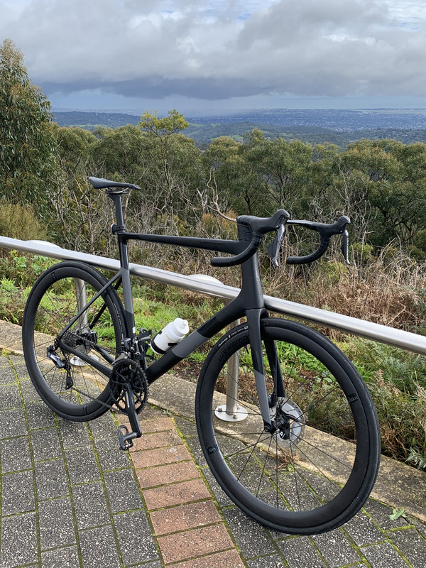

fast commuter on Tubeless 30mm tyres. will take a 32mm CX tyre too. This model Cannondale is endurance road. V. fast and comfortable and has a flat topped carbon bar that is surprisingly easy on wrists/shoulders. Also super light. Edit: Not 2k though.

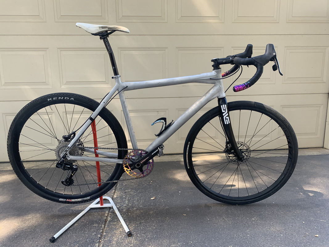

alloy/carbon CX commuter on 43mm tyres.

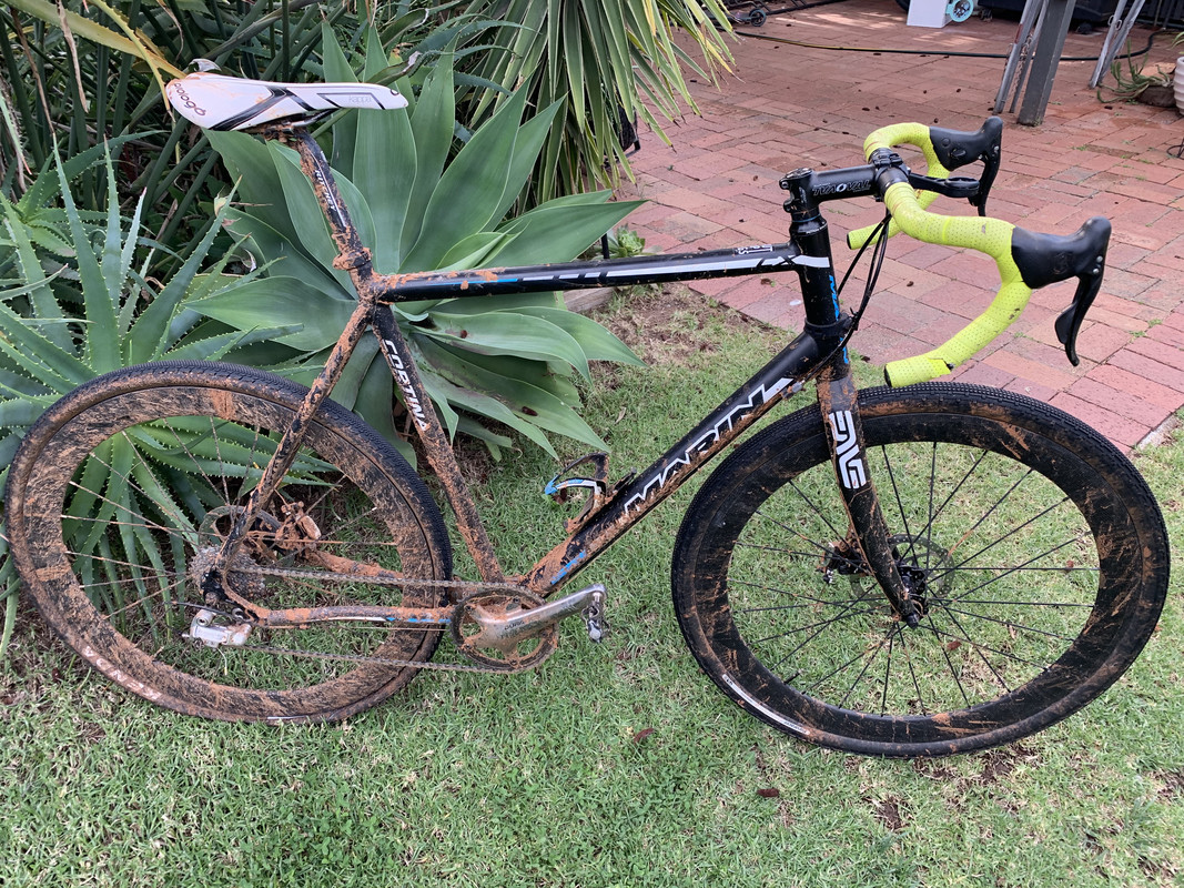

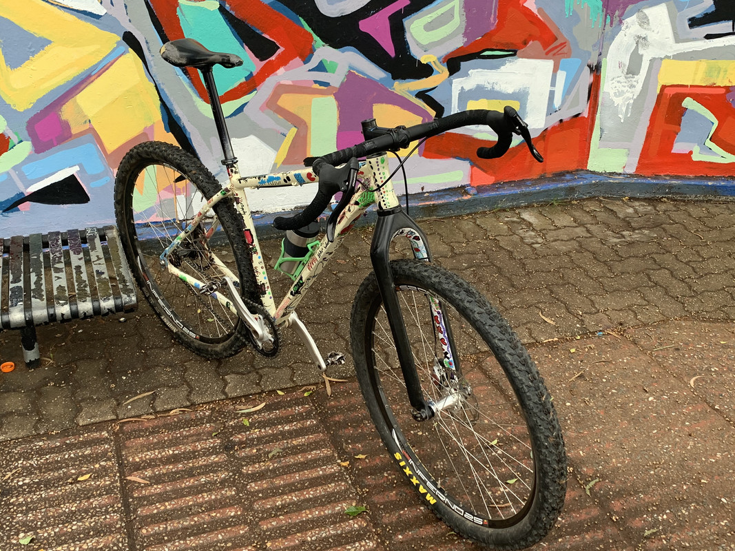

Gravel/ monstercross SS commuter...yep, on Ardents. wearing out some old tyres
I do big km's and all good capable commuters on gravel /paths for the last 5 years.
