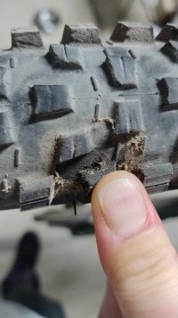

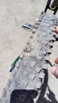

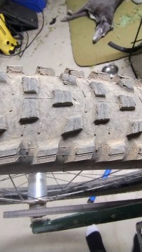

I suppose the tyres fit in here, maybe not the bike they're on, but anyway...
27.5 X 2.4, Maxxis Forekaster, TR EXO. Weighed at 838g. Used as rear tyre with Huck Norris sandwich. Lasted 585km. Run probably 2/3 of is life on road with some decent commutes in October.
Plain EXO version usually wear better than this did. There was some decent crumbling of the side knobs early on. I killed it on my last ride on the first rock garden on Cressy at the You Yang's for those that know it. I haven't ever killed a tyre on there. This one was a little unlucky I think.
It looked like the side knob was getting peeled off and when the knob flexed the sealant couldn't do it's job. I checked the inside when I took it off and nothing really noticeable.
