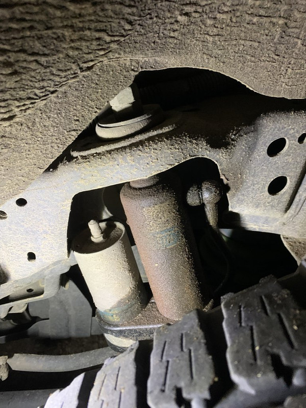

My bespoke Billie's have had an issue after 80,000km ish. Left rear shock weeping at the banjo joint. About 20,000km of that has been 4wd or rough track. I will see if the supplier wants to rebuild to find out why the seal has gone, if not I will do the rebuild and just use Ar instead of N to gas them up. Haven't lost much oil or pressure but after 400km odd of corrugations this trip the weeping continues, and the shock is still leaking too. I think the remote reservoir may have moved putting some stress on the hose and banjo but a pull down will reveal all.
I had custom Bilstein's on the missus Prado, at around the same 80-90k I dropped it in for a service at the place that fitted the shocks/springs and they told me 2 were stuffed. 3.5yrs... were outside warranty and they would fit 2 new ones.
Said the stroke was possibly bottoming out and fekked the seals, they fitted spacers as well as new shocks. Her Prado has 200k on it now and all been good since.
Was probably a mistake on their behalf but they needed replaced and were out of warranty.
There were a few Billie sets going around that were wrong for the Prado. One place in particular down south was selling mismatched sets and the pogo'ing was something special. These are the big bore, big shaft set with the right set up. I was lucky enough to be involved in the development for the local market. This stuff is $6k or something plus fitting if you pay full retail. I didn't. The leak isn't constant so I am hoping a seal rather than a crack or similar. If so I can rebuild then for the cost of oil which will be free plus some Ar which will come out of my tig bottle. Otherwise they are scrap. The big bore Ironman foam cells are a good product. Despite what you might hear. I have had a good look at them as the development has happened and with custom valving will suit our setup well. I will be happy with going Ironman if the Billie's have gone. Ironman offer a much better product now than the 'others' including the piggy back varieties - I have seen the dyno results. Anyway we will see.

I know where you got them... valving wasn't changed from factory. Probably two or three places can do those 'sealed' units with a slug of liquid N2. Mine is Schrader valved in the remote. There may be some very good big bore bypass foam cells coming... Juicy.
