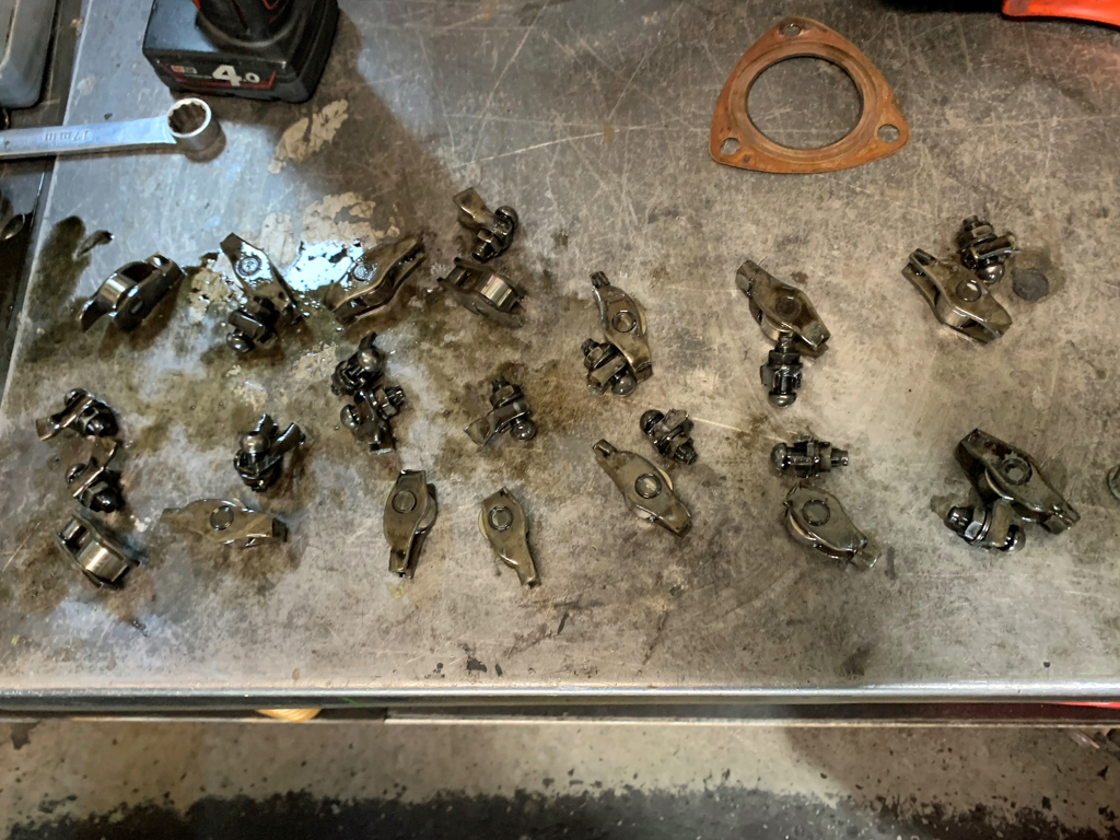

What did they come out of?
3.0 Matsuuda diesel. Pretty common as flow would appreciate. The toothed belt didnt go to the dentist for check ups and had some cavities and lost plenty of teeth. Thing was almost smooth for half the length and rock hard. Mate has repaired a few broken rockers which seem to be a failure point rather than mulch pistons. But this is the first time all were broken. Shows extra effort by the driver. Bloody rockers are over $60 each retail. Top of the engine looks ok through the injector ports. No idea if any valves are bent. That is the next step.
That Brokenium is expensive stuff indeed, only a few places away on the periodic table than Unobtanium.
