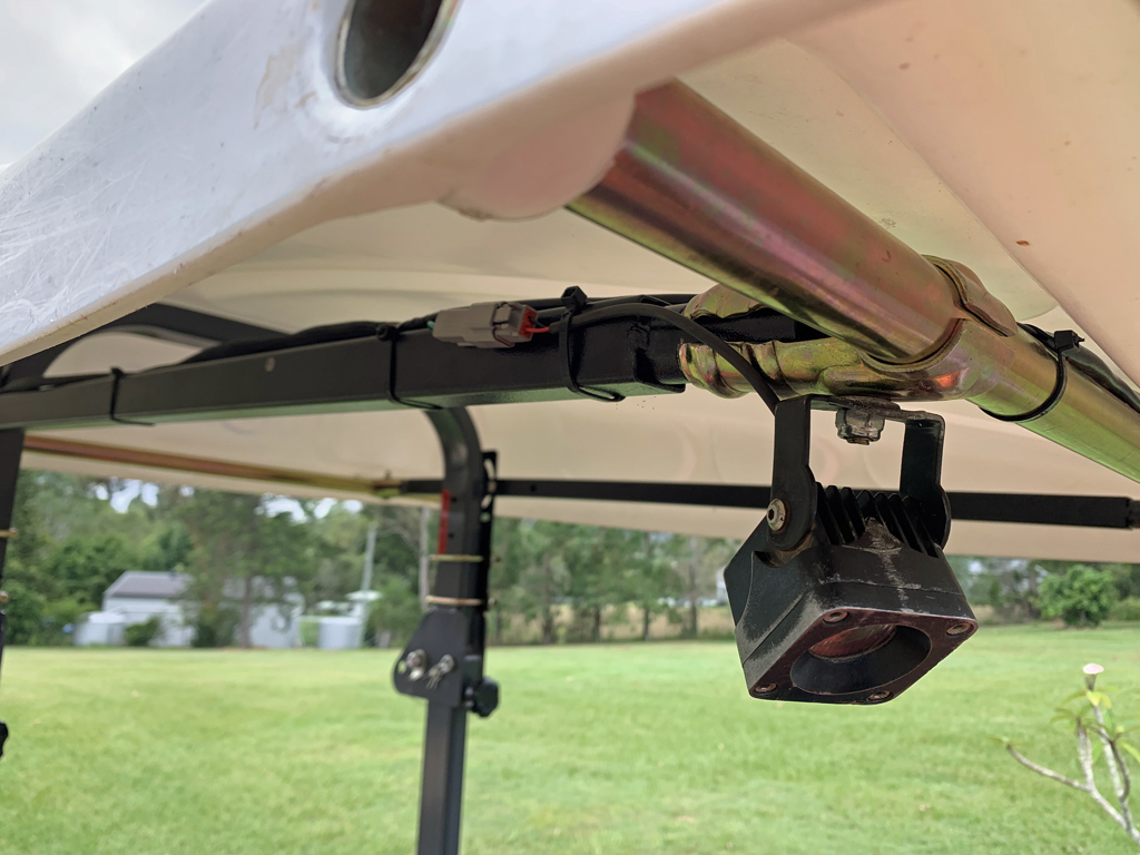

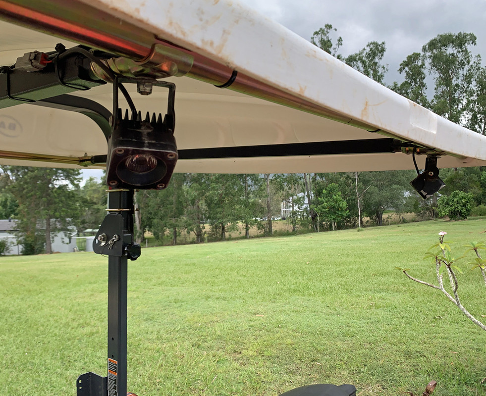

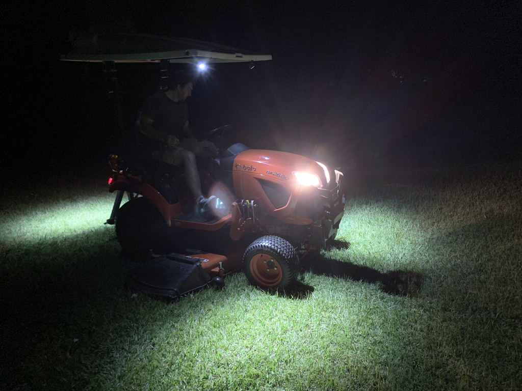

On a lighter note. The factory lights on the kubota are ok for getting home in the dark as long as the loader isn't fitted, then the loader blocks most of the light. If you want to finish the last bit of mowing in the dark then the lights are useless and don't show anything near the deck. Thus some work lights were needed. #1 ditched these little leds that were rock lights on his 4wd for bigger ones so an hour or so with some cable and DT connectors and we have a result. The leds had a 6mm hole that was quite close to one edge so drilling it out to fit the M8 bolts that connect the canopy to the frame was not possible, but I have a mill and end mills. Done. The canopy bolts are fitted upside down, presumably to stop the exposed bolt catching on stuff, anyway these can go the other way and make a perfect mount for the little lights. Then some deutsch connectors which have to be the easiest things in the world provided you have the right crimping tool and voila!
Brackets are just tight enough not to vibrate loose but slack enough to be able to move them around to change the spread of light.
