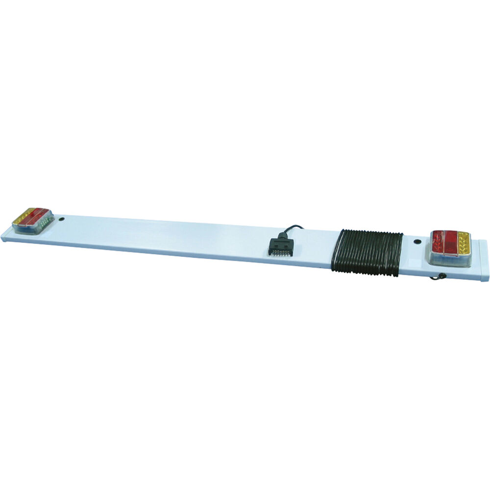

Light board, I don't remember paying that much for it but I bought one of these and cut it down to size.

I made up my own lights and numberplate holder for the grip rack but just did as @ausdb says and bought a complete trailer lightboard. Just get it with a flat plug or swap for one. I also made up an led light on a long lead to throw on the kayaks when they are on the box trailer.

On the light board I was going to DIY but after seeing the price of LED trailer lights, factoring in some cable and a plug CBF (not the Canfield Balance Formula type) kicked into high gear and it was easier to trim down the premade one.

I think I'll be doing the same regards the light board. I only have a relatively simple workshop - doing the electricals is fine, but totally fabricating my own board from scratch is more trouble than it's worth for me.
If you have any pics of what you did in terms of mods and how you ended up fixing it to the rack, I'd love to see them.

Cable ties...

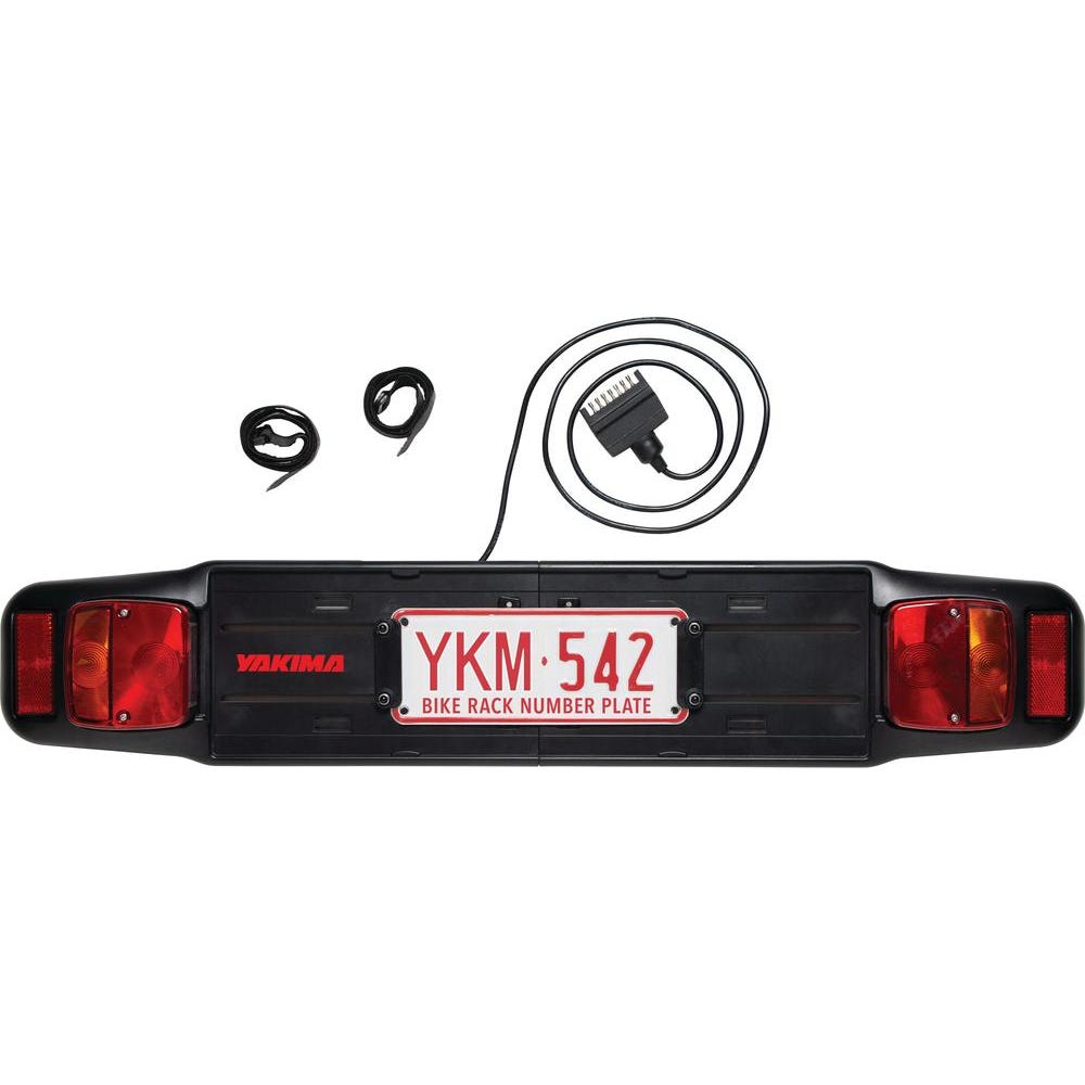

Looked at this one, only $15 more than the Supersheap one and seemingly ready to go:
But apparently not. Like other Yakima prods, it's setup for the US market, meaning that for the blinkers to the on the correct side the board needs to be upside down (based on sticker placement, no idea why this is so), and the number plat section is set up for full-sized plates. According to reviews, this means that you have to mod the board to fit a smaller bike carrier plate and that the lights for the number plate don't actually light the plate up properly.
@ausdb did you install a light for the number plate on your modded system?

Cam straps work well for attaching light boards - the ones we get in have them with them but you can get the heavier duty metal cam versions from bunnings cheap enough - the only thing to be aware of with the LED’s is that numerous newer vehicles have blown bulb indicators that the LED’s trip - on some it’s just a light that comes on the dash, on others it flickers the light board - you might need to install a resistor box or use incandescent if that’s an issue - if you go the incandescent route it’s cheaper to buy the large 7 pin round type off eBay and change the plug the flat yourself.
