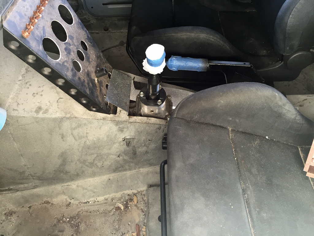

Escort had the engine and gearbox in again for mount set up. Few changes since last time now that the front end is fixed. Needed to drop the engine lower and that means either a modified Gp4 crossmember or I make a new one from scratch. Either is ok. The gearbox is from an NC MX5 and doesnt have individual mounts. I can run a new cross member across the rear of the box and pickup the beam supports on the gearbox with a motor mount. The front engine mounts are pretty striaght forward with chassis brackets and engine plates with isolating blocks on pipe between.
The gear lever falls perfectly to hand and the hand brake from the XR4 is perfect though I will need to mount the seatbelts off the sides of the tunnel rather than the top which was standard Escort.

Thanks, I was very rough getting the box in, the previous owner was using a Sierra box which has a long shifter mechanism and the cut out was too far back so I just used the jigsaw and folded the excess up by hand to do the test fit. It will all be welded in properly once the position is confirmed. I think I have found a fabricated pipe cross member that will work and I can get offset steering arms to suit. Just waiting on final dimensions to confirm. Heaps easier than starting from scratch even if it means a couple of weeks dealy while it ships ftom the UK. I have convinced my son the seats should come down a bit so I will make a plate frame up and finish the inside mount.
