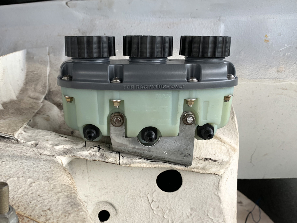

Had to rethink the brake reservoirs on the Escort. They had a weird proprietary fitting and there just was not enough head room to make them fit properly. The bulkhead in front of the scuttle is a horrible combination of angles and hollows and the only real way for the reservoirs to fit was in front of the bulkhead but then the hoses had to run uphill to the top of the mastercylinders. Not happy with that arrangement and how close the reservoirs would have been to the headers. A little research found a triple reservoir with separate chambers.
So today was make a bracket day. Again. The bracket had to weave in and around the factory metal and also releived to miss reinforcing under the reservoir so a few chamfers and angles. I also forgot which end I had just linished and managed a nice skid mark burn on my thumb. I then had to recover the bracket from the grass.
Pretty happy though I had to do two bends the old fashioned way by clamping the material between two pieces of steel in the vise. And then belting the living shit out of it all.
A little tidying up still to do and drill four holes for mounting and then four M6 rivnuts. Oh and some nice M6 button head screws in lieu of the M6 rod that is there at the moment. The consolation was that the folder I needed to do this would have cost around $100k.
These will feed into bulkhead fittings through the firewall and from there hoses to the mastercylinders. I will research the caps and see if I can fit some level indicator caps but that is not urgent at the moment. To comply with the ADRs we only need visual indication and that is provided on the reservoir body but I would still like an idiot light at least on the front chamber. To be continued.
