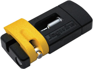

I got a needle driver tool for inserting the barbs into brake hose. Works well. Rule those FFFFFFFFFUUUUUUUUUUU..... moments out of your life ;)
jagwire also makes a nifty hose cutter as well.
Is that one of those tools that cuts the hose as well?
