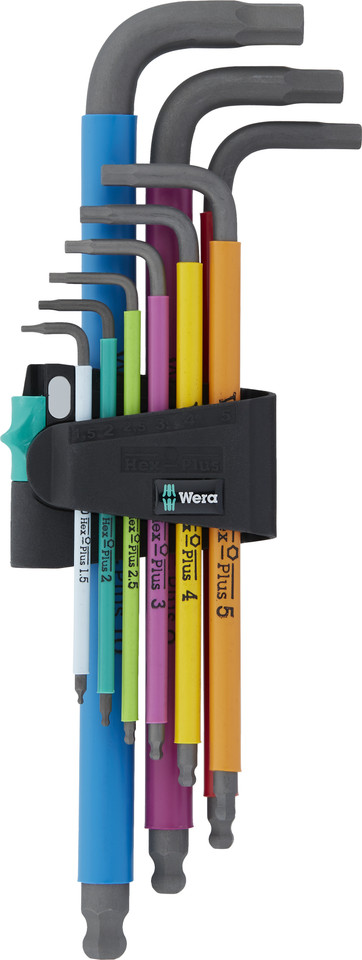

Did you see the price of some of the Wera tools??
$94 for a set of Allen keys when you could buy the same set for 18 euros from Bike Components ($30au) now 21 euros and out of stock.
I dont mind buying local when its near the price, but 3 times is taking the piss.
